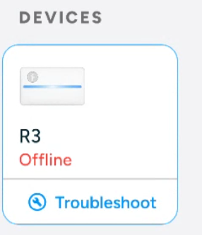

How can I tell if my Rachio has intermittent connectivity?
You can tell if your controller is experiencing connectivity problems if your device displays "Offline" when you log in to the Web or Mobile apps. For quick troubleshooting help, tap the "Offline" banner to access our in-app Wi-Fi help tool.
