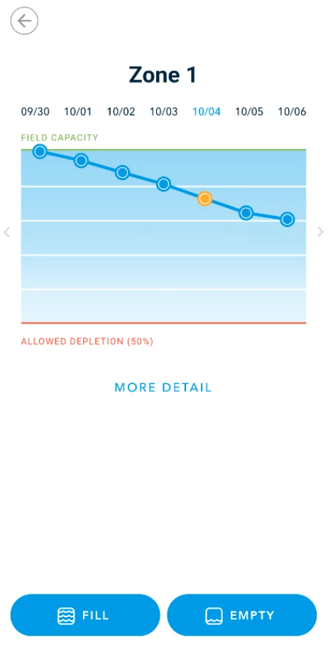

Flexible Daily schedules will record the estimated moisture balance of each zone using evapotranspiration (ET) data provided by your preferred weather station. To see the moisture level calculated in a given zone, use the "Moisture Levels" screen (accessible via the mobile or web interface) to better understand when & why a schedule will run or not.
  1. After logging into your account, go to the "Zones" tab. Select the zone you wish to review and click anywhere on the zone tile.
  2. You'll see the Zone Details screen as well as the soil moisture percentage.
  3. If you click on the Soil Moisture percentage, you can view the Soil Moisture graph to see your Moisture Levels.
    For detailed information, select "More Detail" and view:
  • Previous Moisture Balance for the prior day
  • Any NEW irrigation events (credit)
  • Any NEW precipitation/rain events (credit)
  • Crop ET (debit)
  • Current Moisture Balance for the day with that day's debit & credits calculated.

Every day we'll look at how much "fuel" your lawn has used and calculate when/if we've hit the refill point (allowed depletion). By default, we set the refill point (allowed depletion) to 50%, however, this can be changed to anything from 0-100%; thus the name Management Allowed Depletion, or MAD.
The Moisture Level graphs display the percentage of the moisture available within, or how much fuel you have left before you hit the refill point. If MAD is set to 50% and your Moisture Level graph reads 50%, then your lawn's "gas tank" is really 3/4 full and will be refilled when it's 1/2 full. If your Moisture Level graph reads 0%, then your lawn's "gas tank" is really 1/2 full and ready for a refill. Think of it as a percentage of a percentage. Flexible Daily schedules will always water when the Moisture Balance hits Allowed Depletion.
