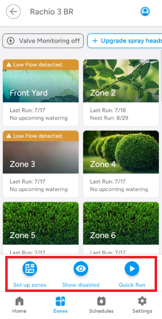

Zones Tab
Allows you to Set-up Zones, Show/Hide Disabled Zones, and QuickRun.
To show Disabled Zones, click “Show Disabled Zones” Click any shaded zone to reactivate. Toggle the “Disabled” switch to Reenable.
Visit How do I set up my zones? for a detailed step-by-step guide.
At individual zones view you may:
  • “Enable or Disable” a zone
  • Review and adjust zone settings under “Edit”
  • QuickRun - the selected zone only
  • Confirm and review the schedules the zone belongs to
  • Review zone monthly water usage
The zone settings are very important for smart features such as SmartCycle and Flex Schedules. The more accurate the zone settings, the more reliable smart programming you will experience.
"A smart device is only as smart as the data it is fed."

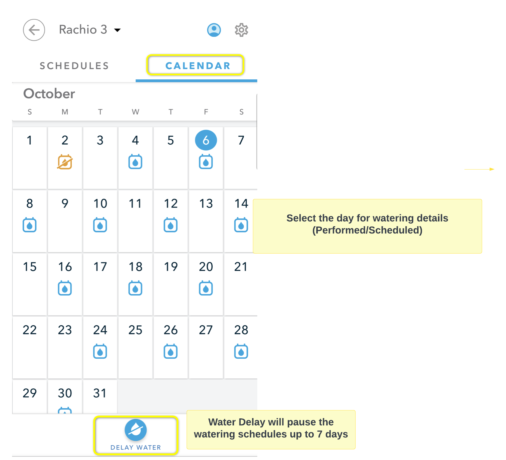

Calendar Section
Monthly calendar view showing water drops at the scheduled watering days. Waterdrops can be color-coded under schedule settings to best identify on the calendar view.
Water Intelligence Plus skipped schedules will show on the calendar in orange with a line across.
Water Delay is a function that will pause the controller for up to 7 days, and once expires it will resume the regular watering schedule. If a longer pause is desired, the schedules can each be disabled, or the controller can go into Hibernation (formerly Standby) Mode (under the Settings Wheel).
By selecting a day on the calendar, you can review the scheduled start and end times, broken down by zones, including cycle and soak if selected.
