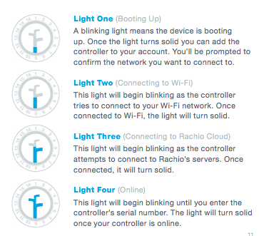

Check the current status of your Wi-Fi network
The Rachio LED on your controller shows the current status of WiFi connection. Use the  light code to troubleshoot if you haven't already.
