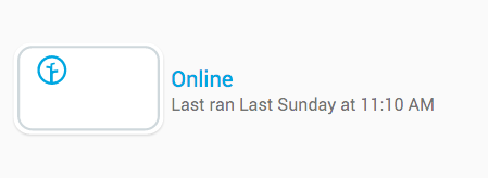

NOTE: The Rachio device must be online for Amazon Alexa to work.  Also, only one Rachio controller can be paired to Amazon Alexa at a time.
